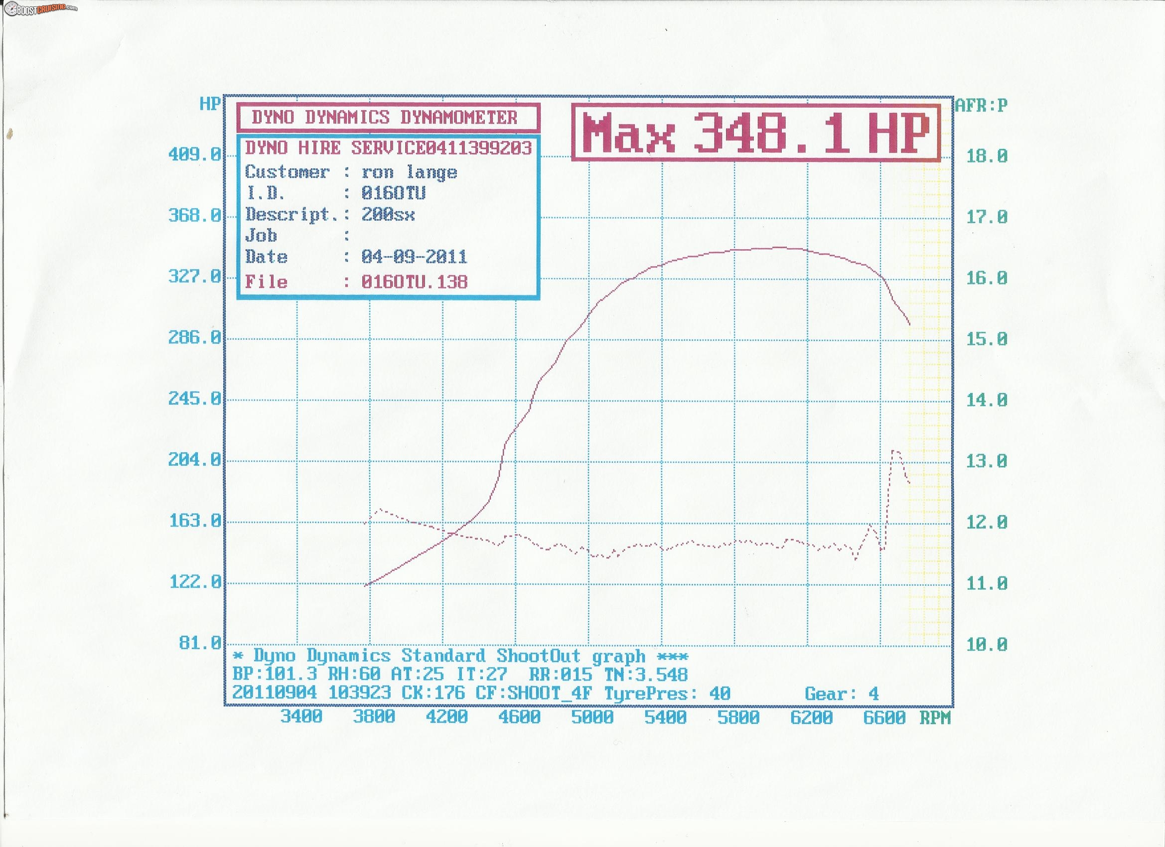

I can't recommend East Coast they blew my SR20 and after a 6k rebuild I was left with a car only 2/3 tuned. I ended up having to take it to GT Auto Garage to get fixed. Personally I think a 2871r is too big for 300hp. If 300hp is all you want then a Disco Potato (aka GT2860RS) is not only going to be cheaper but it will be more responsive and 'punchy' than the GTRS (aka 2871r) but like the others have said some bigger injectors atleast the 550cc but for an extra $10 you might as well get the 740cc ones incase you want to go more power down the road. a fuel pump and a ECU tune. for that power a reflashed NISTUNE ECU is ideal. You should EASILY make the 300hp mark with this set up with more response than the bigger 2871r. There's always more to the story, they seem to be fine with my brothers car? 566hp on a standard crank/bore sr. ![]() |
iamhappy46
There's always more to the story, they seem to be fine with my brothers car? 566hp on a standard crank/bore sr. ![]() I would not be proud of that power output graph.... Peak number is decent but fuck, the response curve and area under the curve is TERRIBLE! Edit: 34psi... with that ramp speed... with the weatherstation off... explains a lot ![]() |
iamhappy46
^^ 58.9 degree intake temp probe temps... LOL |

EssR20
hate to break it to your brother but that looks like a terrible tune Dyno graph isn't everything. https://www.youtube.com/watch?feature=playe...p;v=-Rqj7X_H0Jg ![]() |
