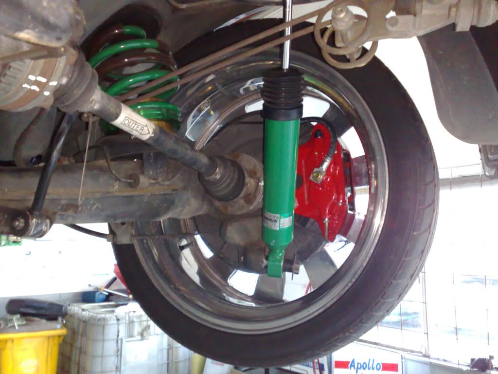

Silver Surfer
Sorry I was thinking of the toe rod. Here is my old Vy sitting on super lows all round no camber kit on 18's with tyres wearing pretty evenly.
Masdarati
QUOTE (Silver Surfer @ Apr 27 2011, 09:53 PM) *
no probs, you are correct in saying that majority of late model commodores do not have a problem with sitting that low, the problem generally comes around when you start going lower then that, ie ssl or sssl/ultra low.

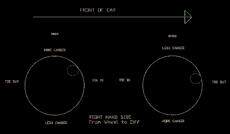

A VY only needs this kit:
SPF2545K - Suited to vehicles fitted with "Factory Toe Adjusting Arm"
A VT requires this kit:
SPF0877K - IRS Adjusting Camber & Toe Kit
VR VS can have either of these 2:
SPF0877TK - IRS Adjusting Toe Only Bushing

I prefer the Superpro, as the long bolt is the alignment tool(get it wrong and you need to go around 350 degrees again, but not that hard) and the nut on the long bolt helps you keep the setting while you tighten the short bolt. Torquing up both sides seperately, just makes it much easier to ensure the settings STAY accurate. I see too many Pedders ones shift during driving sad.gif
My ute had 0.6 degrees of rear camber, with 0.5mm of toe out and VY utes have no toe links and with the 10mm longer swing arm length due to the way I aligned the bushes, it reduced squat(springs could counteract squat due to fulcrum being longer) so tyres could hook up better yet roll centre allowed great handling. Hell, I had 2500Km's on the tyres with 400+rwK and tyres were wearing perfectly even.
