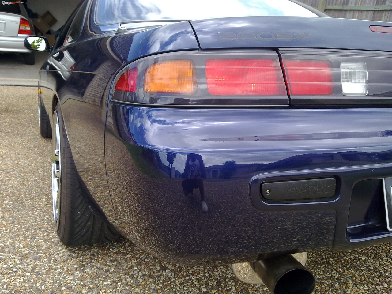

i'm running 18x 9.5 + 26 on the rear and fitting 285's i'm not into stretch, but still wanted fairly flush. And for me its pretty spot on. If you want anything crazy with big stretch then obviously go with a lower offset.
not the best photo because of the gutter i'm sitting on, but you can just squeeze a finger between tire and guard, but i could go lower.

QUOTE (BusSpec @ Jan 18 2011, 11:36 AM) *
To give you an idea
I like this car. It looks tough and not stupidly done. Go for something like this.
