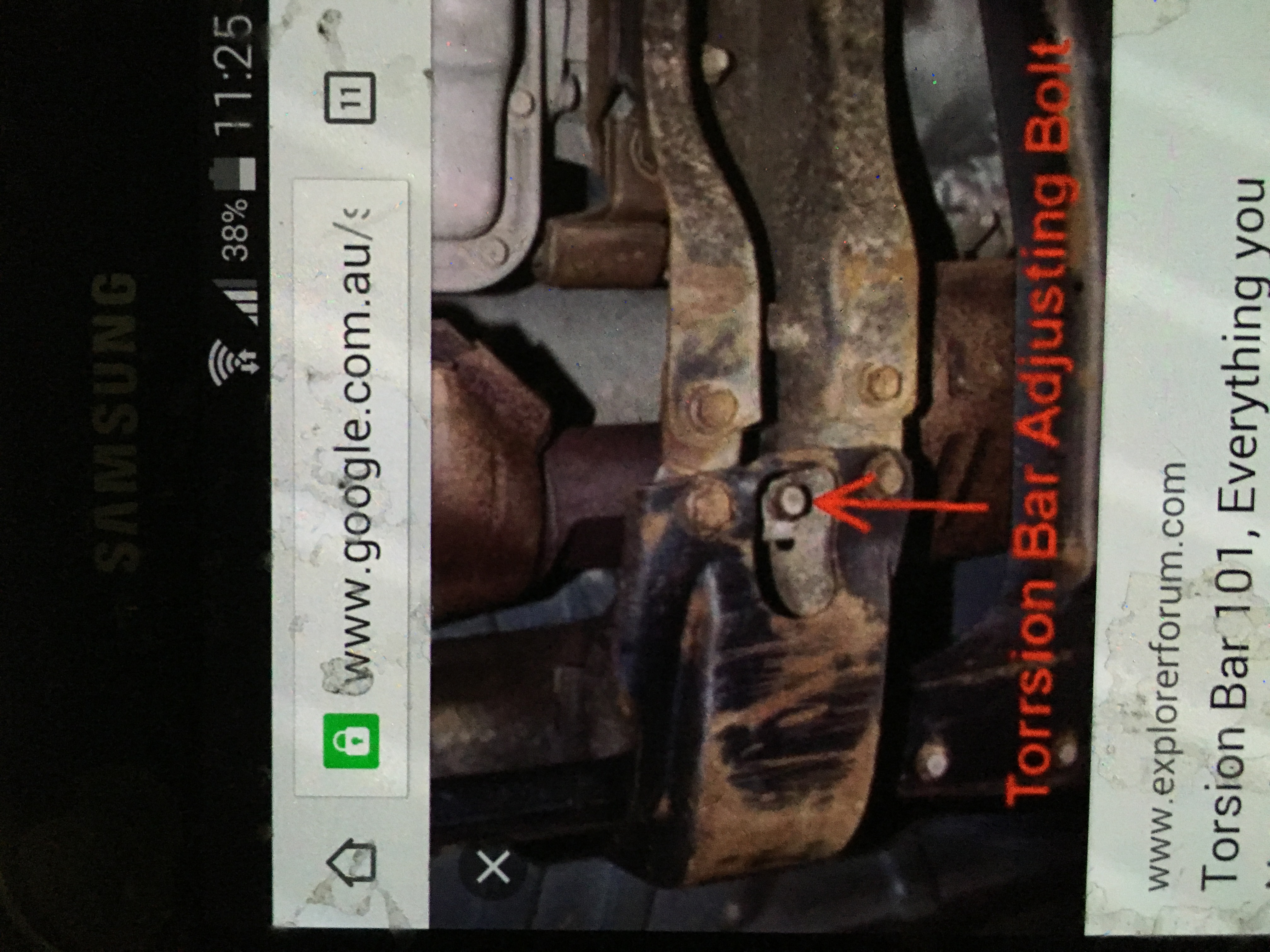

/ is this the right bolt to wind up ( in the picture)
Flash635
Looks like the right bolt. Undo the bolt to raise. You'll have to adjust the toe in after or you'll carve your tyres up.

QUOTE (campbellhull @ May 29 2016, 07:27 PM) *
The toe? Do you meant the fairings/ panel?
Toe in, wheel alignment.
Probably the camber too but the toe in does more damage.
