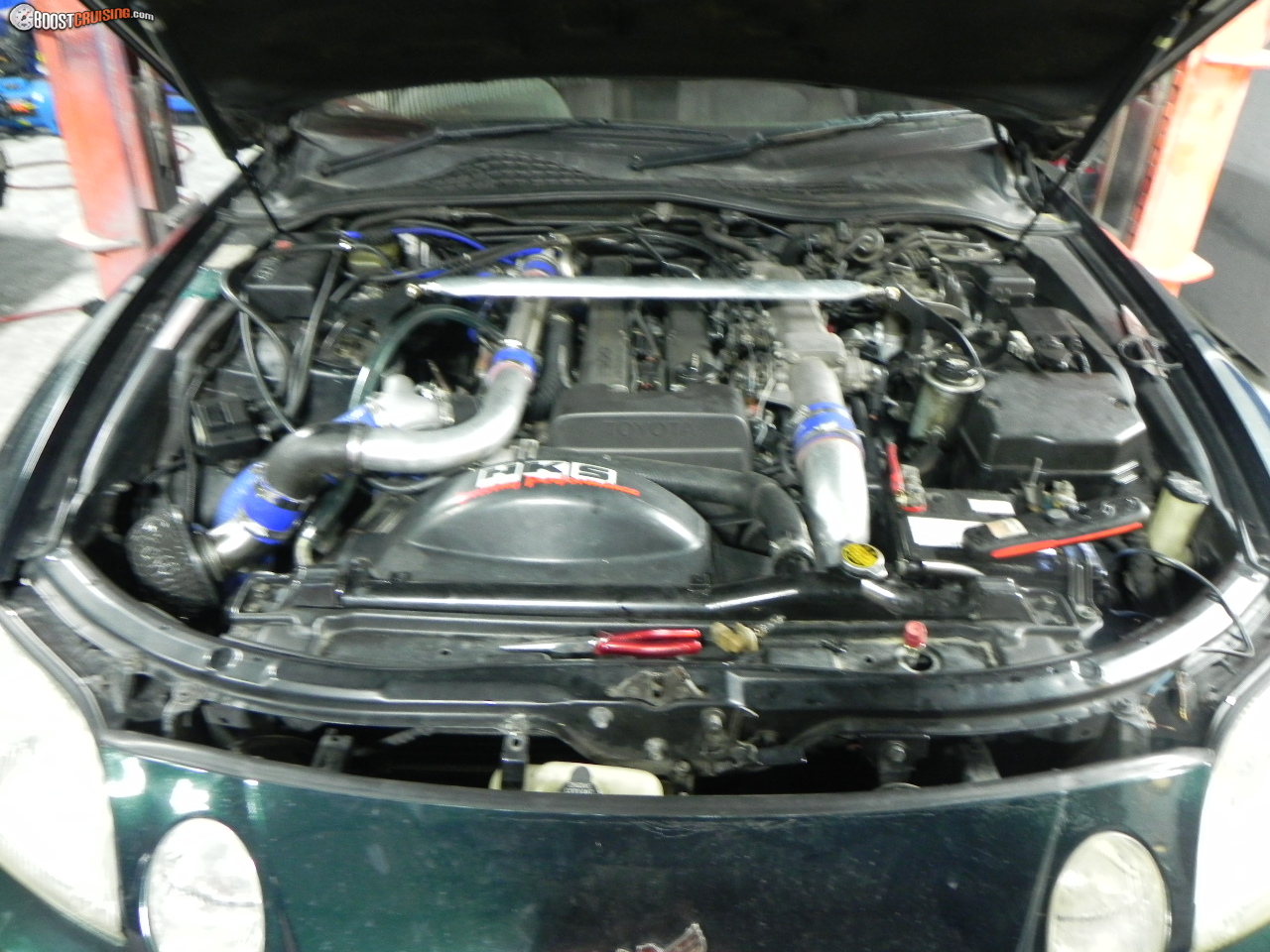

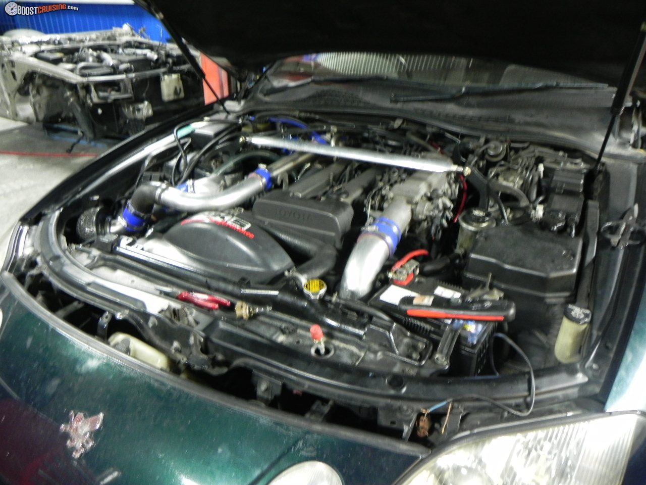

hey bud just got to work and forgot about the photo , but i have an old shot of the bay, u can see the set up! when i can,will give you a closer shoot of how the dumps are layout .... cheers!

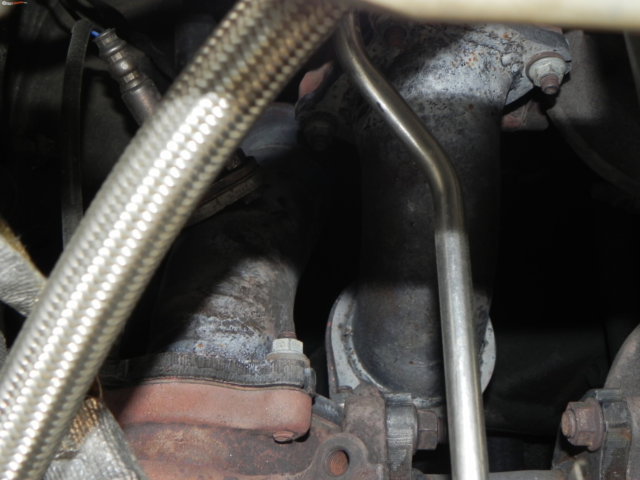

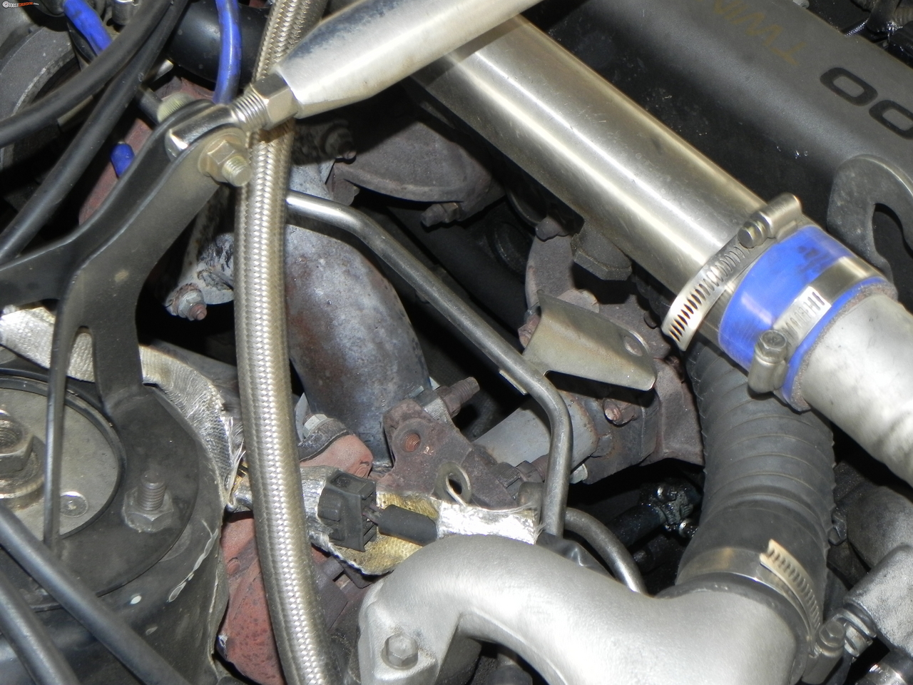

driftjz
QUOTE (swervedriver @ Mar 29 2011, 07:21 PM) *
Great power for stockish boost. Never heard of anyone doing that to the manifolds... does it have any setbacks? Who did the work? Edit: want to make one for me too?
The set back was from the drawing to the weld! the measurment was abit off so had to re do few things, extend here , cut there but was pretty simple .. and the oil line need to be f around abit that was it...
i did the drawing and the boys up the road done the weld, we can duplicate the kit easy as we have JIG...

hope this give you an idea, pretty sweet and easy...
