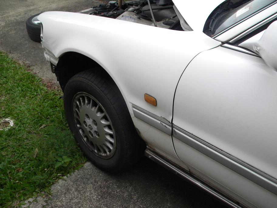

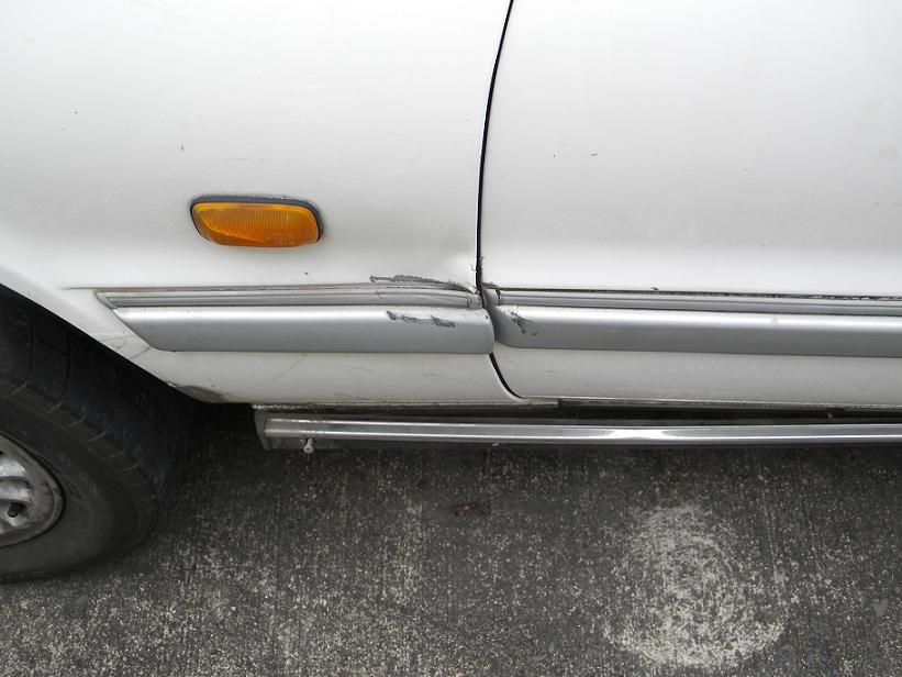

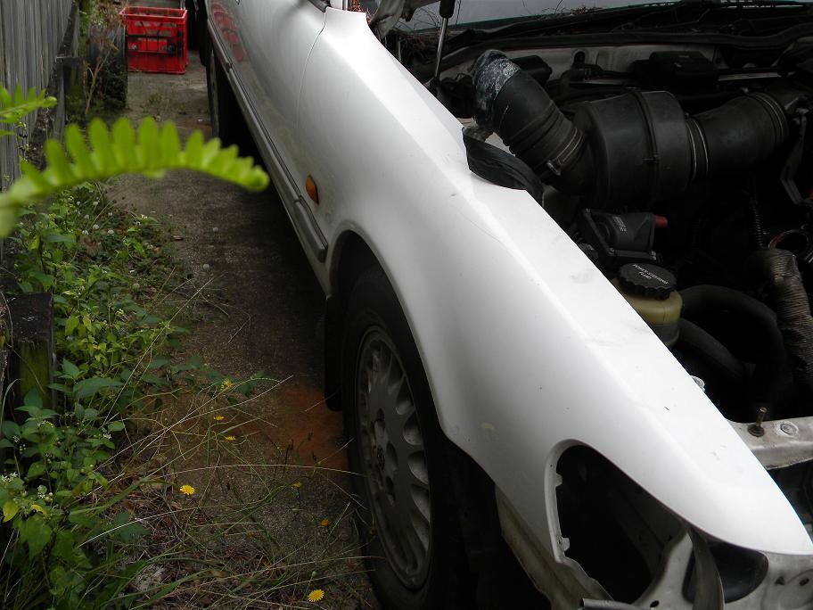

I'd have your guards as well.
02JZE
Post #947
First in with the money gets them,.
02JZE
Post #948
guards are not perfect so make it 80 for the 2.
1.5jz cressida
Post #949
well if craig gets them he does im still waiting to finish the tuning
OIM.666
Post #950
I don't want his busted ass guards. I was telling you Dan, that I would have guards to sell you as well.

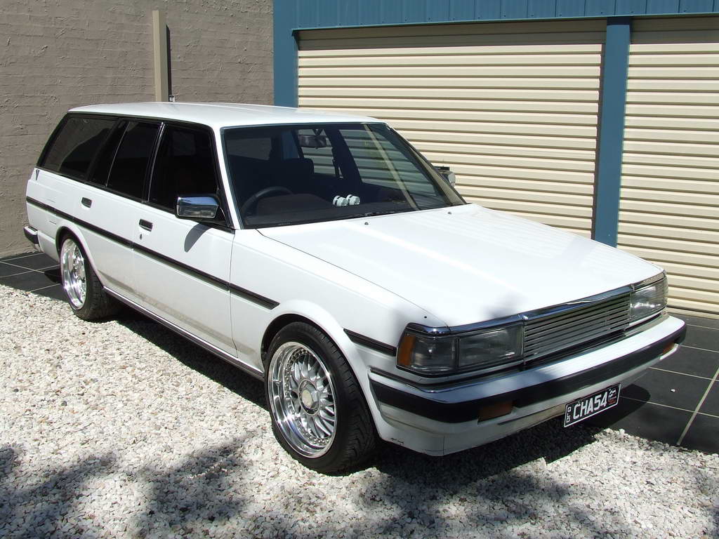

GX70G wagon. VVTI Single turbo JZX100 1J and R154. 33GTR front calipers, BA falcon rotors, JIC coil overs, FD RX7 rears, G series hilux rear with LSD, Power FC, FMIC etc.

this ??
Post #962
QUOTE (slide1600 @ Nov 26 2009, 04:01 PM) *
:thumbsup:
That was for sale a few months back, did you buy it? Or it didn't sell?

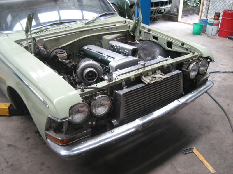

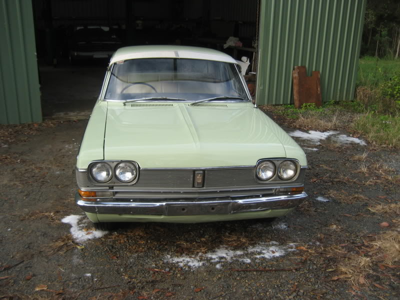

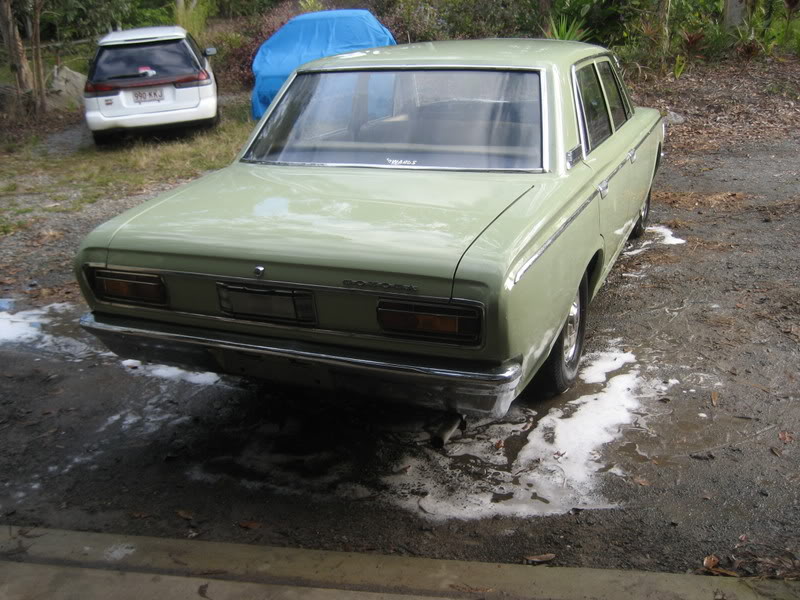

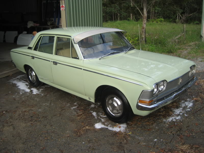

Have you guys seen al from AM autos new project. his 2j powered crown is epic.
Pics and link to build thread.>> http://www.toymods.net//forums/showthread....255&page=11

i bought it about 3 weeks ago. Makes a nice daily sister for the 1J RA65 :thumbsup:
That crown is vewwwy cool!
1.5jz cressida
Post #965
thats a sexy car mate, looks sweet,
Post #966
QUOTE (slide1600 @ Nov 26 2009, 04:57 PM) *
Awesome I was thinking about going to have a look at it when it first came up for sale. Looked like a great package.
pig060
Post #967
slide 1600- that was jp's old car. its a pretty clean wagon you have there. i was going to buy it a while ago. but i just started to build mine when i seen it at his house. cant wait to get mine going then might have to get a cruise happening hey guys???

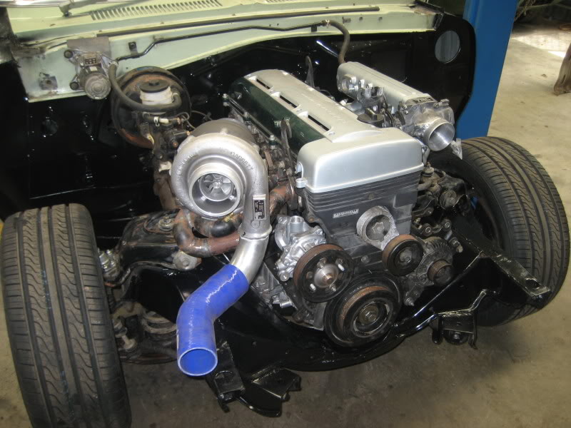

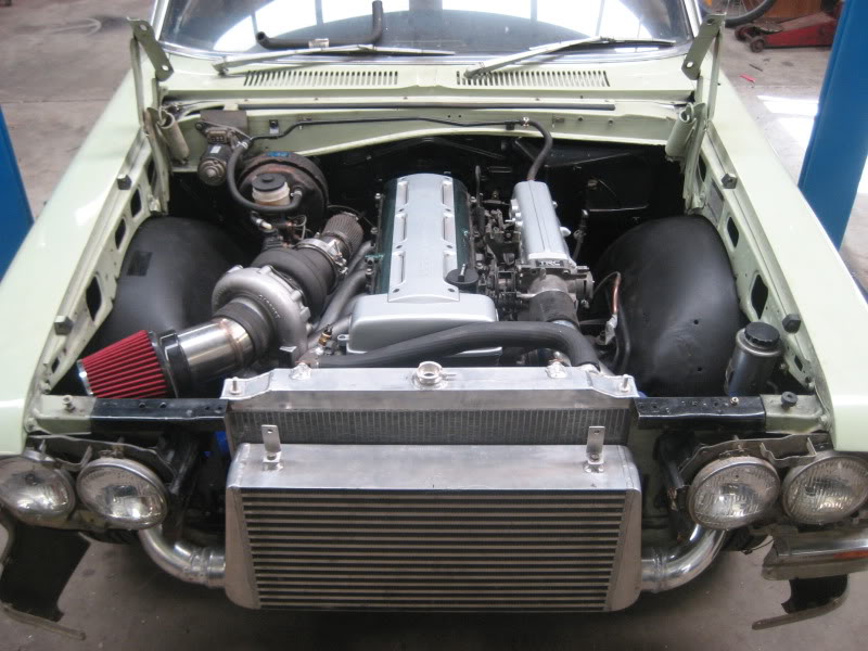

my new custom steampipe exhaust manifold, alloy intercooler piping, 3.5" stainless dump pipe with plumb back gate.
car is off this thursday arvo to get the rest of the 3.5" exhaust done from the dump pipe back. getting new surge tank made under the car with new bigger fuel lines and two 044 pumps mounted.
bazr33
Post #970
shit hot engine bay there pig060

That looks mint pig. how much did you pay for all that piping ? fmic and manifold? i love it. not too keen on the high mounted wastegate is that the only place it could be put ? What size is that gate?
pig060
Post #974
exhaust manifold was 1000 (steampipe), piping was 700 i think (alloy). i wanted the gate mounted high as its easy to get to when i get it tuned. when it was in the commodore it was mounted right under and we needed to change the spring in the gate when on the dyno but was to hot to get to and had to wait until it cooled right down. so i wanted it up high to get to easy for tuning etc. its a turbosmart 48mm gate and yeah there is plenty of room under the manifold.
