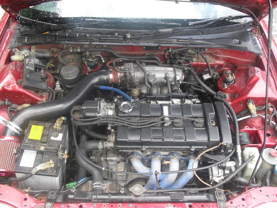

    Very clean mate. I've done the B20 swap, are you running the 16 or 18 head or just the 20? If just the 20 it's a bit of a waste!
    Edit: Just seen the last photo, you should looking into getting a head conversion kit and utilise either a Type R or a B16.
    xcfalconute
    just the b20 head atm sone to be b16b
    Kane
    Ahh so a Civic Type R head, you will also need to socket the ECU. I didn't do this with mine since i upgraded to OBD1 and just ran an S300.

    Do you already have the B16B head or are you just planning on getting one? And are you going to be just doing a basic B20 Vtec build by sticking the parts together and leaving it or are you wanting to get some decent power out of it?
    Cos if you don't have a B16B head yet and wanna build a high power engine you should just get a B16A head and have it ported/polished while the engine is being rebuilt as it'll be cheaper. Then get some higher lift cams, dual valve springs, recess the pistons and you'll be making a shit ton more power than a B16B head would make. smile.gif
    Since you're going to be needing an aftermarket computer to run the engine it only seems logical to do the headwork while it's being rebuilt.

    GSI-PSI
    i cant seee any b20 in there?.... last pic shows a B18B motor
    xcfalconute
    QUOTE (GSI-PSI @ Feb 1 2010, 01:36 AM) *
    omg come see for urself it just a b18b tappet cover and mainifold its a b20b8
