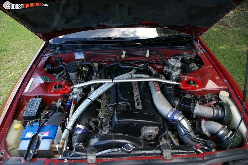

Engine: rb26dett
Exhaust: hks dump pipes to 3". 1 muffler.
Suspension: almost standard height springs, koni adj. shocks. all new eurathane bushes and pinapples and some adj. arms/
Wheels: 17x9.5 bbs 2 peice rims running 255 federal 595ss (next tires to be the 595rs

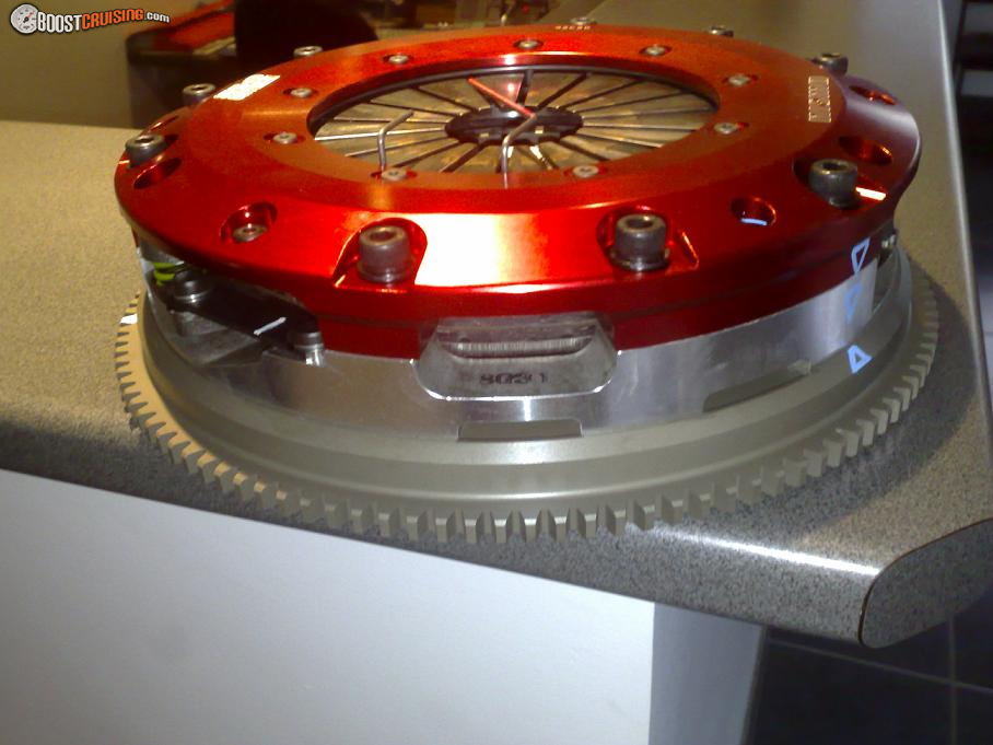

Modifications: wolf v500 ebc, 2860-5 x2 turbo's. hks intercooler pipingkit. cusco half cage, remote oil filter and oil cooler, dba 4000 rotors, removed hicas. 264in & 272 ex cams with adjustable cam gears and some nice exhaust porting on the head. full rebuild with cp pistons, spool rods, acl bearing, 33gtr crank, tomei oil pump, head stud kit, high octane sump+extended oil pickup (almost 8L of oil now) tomei oil feed restricter and an extra drain hole at the back of the head. some other bits and pieces. also running a nismo supercoppermix pro clutch. and 2 apexi super suction pods.
also not using afm's anymore.

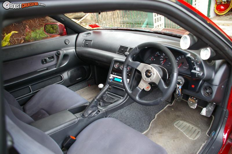

Stereo Audio / Visual: umm whatever was in there when i bought it some mp3/cd player, couple of speakers and an amp.

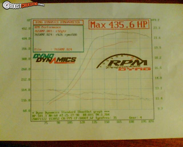

Estimated Power: won't know till next week when i finish the run in period. was at 435atw but now it is running cams and boost will be upped a little bit. so not sure. i'm thinking at least 470 reliably.

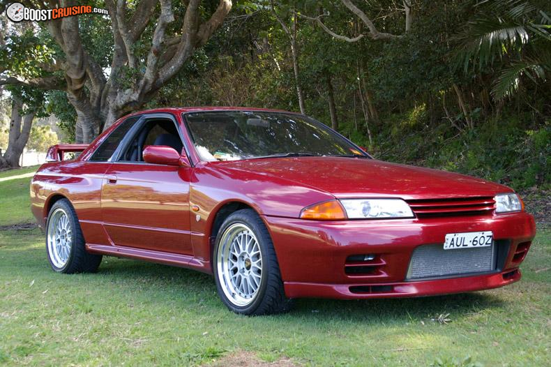

these pics are from when i first got the car. it's got queensland plates on it now

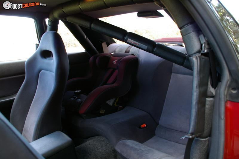

    Always loved the r32s ! Expecially the GTR's
    I bet your kid feels safe with the cage surrounding him/her wink.gif
    bloodzkull
    ok baby seat is not mine. lol i don't have kids haha
    atleast you'd know that baby would be very safe back there with its bucket seat and roll cage tongue.gif

    Mines_R34_The_Ultimate
    Fantastic example of a clean 32 GTR mate. Even stock the 32 GTR has a certain "dont fuck with me" attitude to it
    John.
    BBS LM's..
    Win for you Sir!

    Brendy23
    love the interior. so tidy and everything has its place nicely.
    on_boost
    why did you put the oil filter there? i would of thort it would be easier to get to it facing the other way around?

    bloodzkull
    QUOTE(on_boost @ Feb 26 2009, 06:54 PM) [snapback]1283647597[/snapback]
    good car but
    actually found it's easier this way. as those braided lines run to the other side of the car for the oil cooler. plus there isn't anything in the way this way anyway
    116hks
    Sweet ride mate. I see Peter's tuning the car hey. Nice bloke, i've just had my car up their last year. Very happy with the outcome and the info he gives ya. You'd be very happy with the way the V500 makes the car run. It's like having a standard vehicle again. I've got one in mine, and couldn't be happier. Gl luck with it mate.
    bloodzkull
    QUOTE(116hks @ Feb 26 2009, 09:20 PM) [snapback]1283648570[/snapback]
    had the tune pictured a done a while ago. went from a power fc to the wolf and honestly one of the best things i've done. plus i'm more then happy with pete's tuning and other work. quite often i'll go down to drop the car off or something small and stay for the next couple hours talking about stuff.

    boostnpulsar
    wish i could have been that baby! fucken sex gtr mate! 32 ftw! are u runnin stock twins or are they n1 items, very impressive awd power figure! kudos 2 u mate!
    bloodzkull
    QUOTE(boostnpulsar @ Feb 26 2009, 11:00 PM) [snapback]1283649125[/snapback]
    lol read the mods section. they are garret 2860-5 so same spec as 34gtr n1. wouldn't push this power on standard ones.
