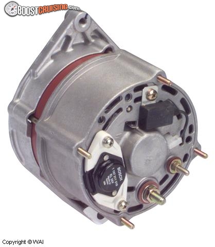

Bosch Alternator Terminal Pattern Name? - wanna find out what this type is called to find another one similar

is there a name for this particular design of terminals on the alternator? need to find other alternator with same type connections. if you know any cars with em on please tell me

Is that your 120amp alternator that died? If so I'm pretty sure it's part number is BXU12121A. Which is a universal alternator. The terminals are B+, D+ and W.
W is a stator output (so basically a tacho output),
D+ is the warning light output,
And B+ is the battery sense terminal.
Most alternators use these terminals in some form of layout. It's pretty much as basic as it gets.
You're still chasing an alt to suit your Patrol yea? Any alt from a L or Z series Nissan engine should bolt straight up. Pretty sure most were Hitachi's too btw. So you'll need to convert the wiring back to the original plug style. Otherwise just grab another universal Bosch unit

This x 2
