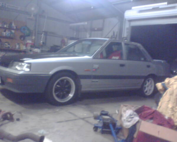

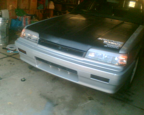

Painted the bonnet in satin black. Normally i wouldnt, but the bonnet had been rubbed back and painted in primer by the previous owner at some stage, so needed a quick hit of paint to stop it turning to shit.
Looks tough as haha.

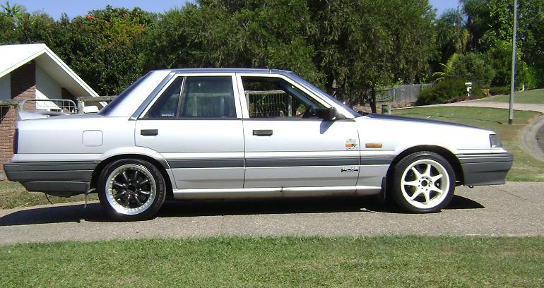

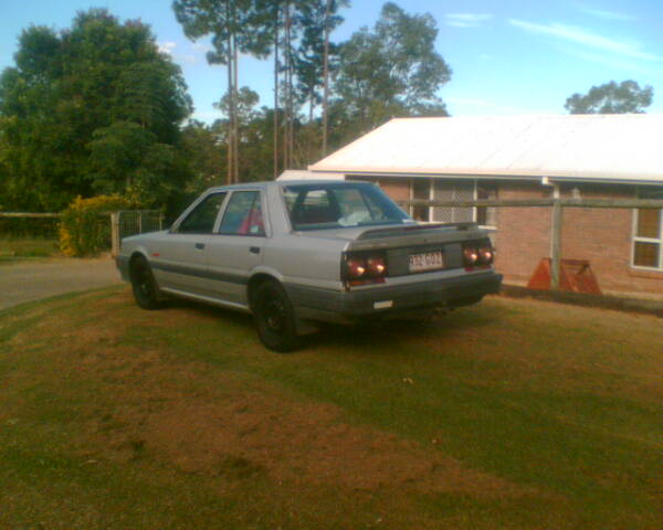

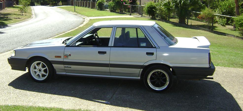

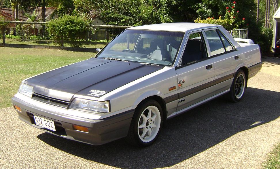

This is the beast how it sits now. I think it needs to lose height for the 'look' but so far im happy with the handling of it except for some body roll which really needs to be addressed.
I'll try to get some 'action shots'. there is an industrial estate being built nearby that has a lot of smooth wide roads (for trucks) that allows for good safe slides. Its just road with a mixture of curves and nothing on either side except for flat dirt :-)
We've all gotta start somewhere.
Modifications to date - Rotors, Pads, Shocks, Springs, Short shifter and race type steering wheel, Wheels & Tyres, Extractors and exhaust, CAI with pod behind front bar, Top Gun leads, MSD coil, Bosch Super 4 plugs.
Things i'm starting to really need - Anti-swaybars, better drivers seat, possibly a hydraulic handbrake but im trying to not use it, need to fit the minispool (to add a bit of predictability mainly).

Looks good bud... Like the mismatch rims.

looks sweet mate. just loose the wing ang lower it a bit will look the goods then.gl with it
lil_bobby_260
May 15 2009, 11:45 PM
Its the standard wing so it'll be staying - it has my 3rd brake light in it plus id rather a wing than holes in my boot :-)

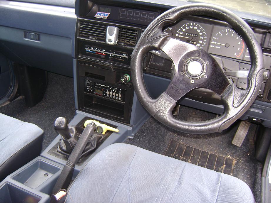

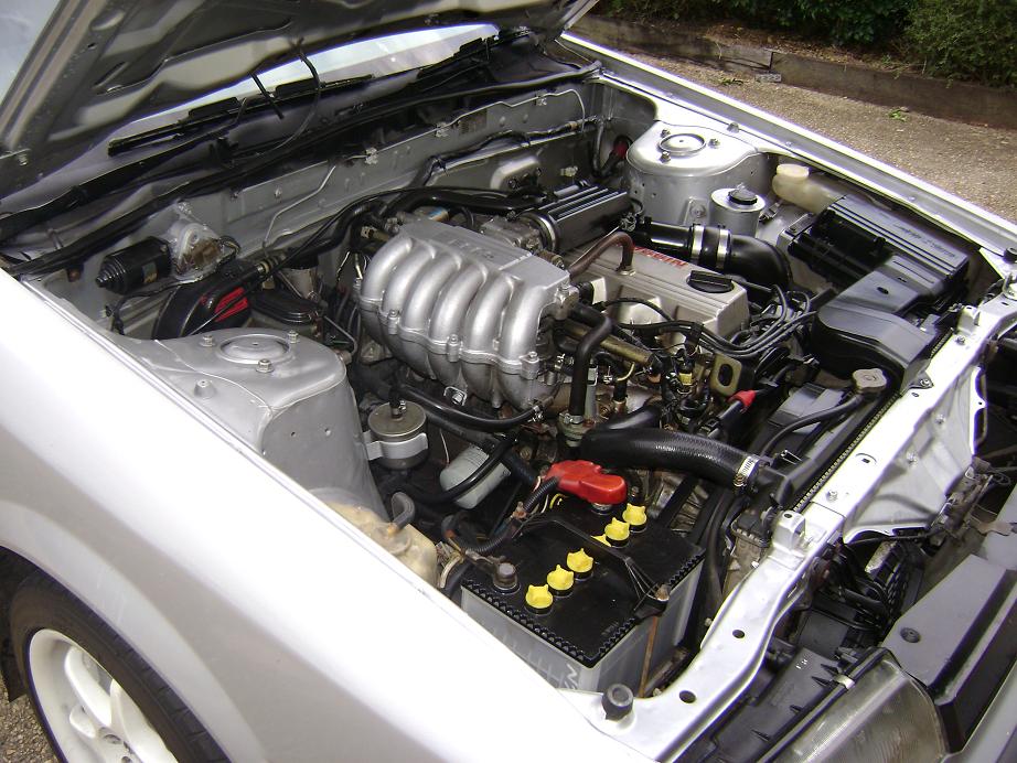

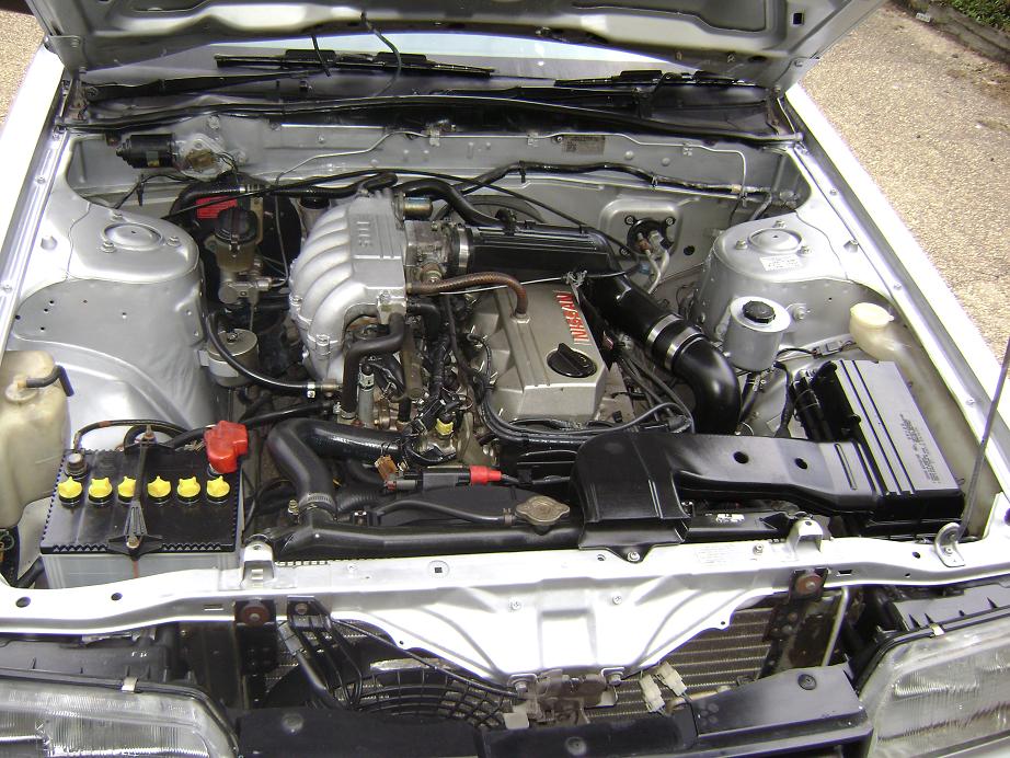

Surge tank fitted with a VL turbo fuel pump :-) not sure if the pump will make much difference but it came with the tank setup. Yeah i heard the stories about them running out of fuel when your pulling some half decent lateral G's.
Couple more pics - interior, engine bay not long after i picked the car up, and a quick shot testing the new rear tyres for traction.
