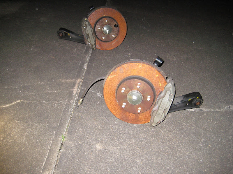

Set of front S14/15 hubs, knuckles, baffle plates and lower control arms
Custom machined sleeves to fit s14/15 knuckles to S13/RPS13 struts (14mm OD, 12mm ID)
Set of front R33 GTS-T calipers

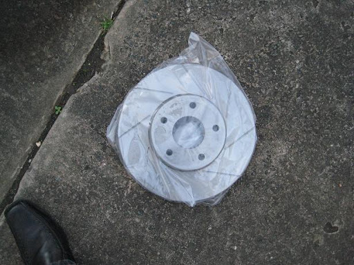

Set of front RDA Slotted rotors to suit R33 GTS-T
Set of ADR approved custom made braided brake lines

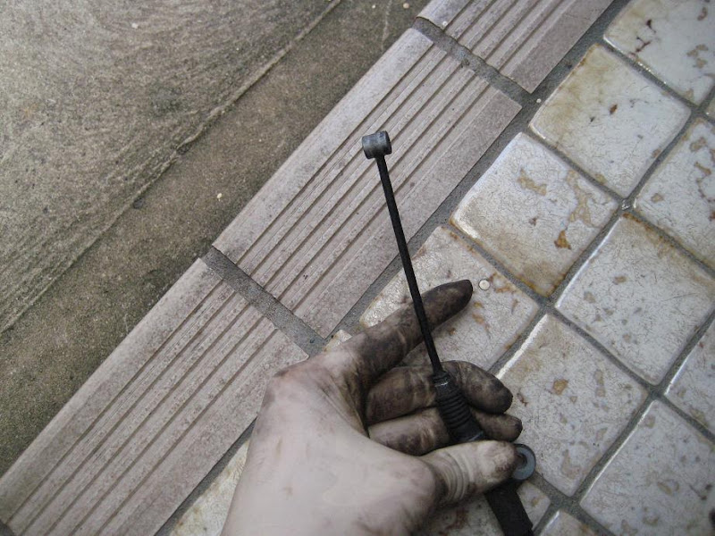

Set of R33 GTS-T handbrake cables

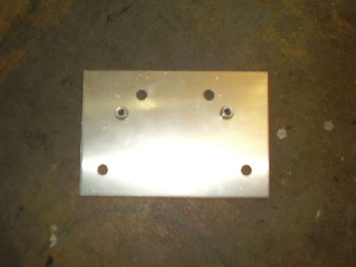

Eagle adaptor

Upgrading seems simple now that I look at it in hindsight, but it was almost torturous while I was there. I made sure to take my time and not put myself in a place where I could risk getting badly hurt or damaging my car, parts or tools.
http://1.bp.blogspot.com/_bnMJJH0sZbM/SZ7M...MG_0546.JPGFrom Phillipses blog
http://1.bp.blogspot.com/_bnMJJH0sZbM/SZ7N...MG_0541.JPGFrom Phillipses blog
Begin first by chocking the rear wheels with bricks and jacking the front end up with a good jack underneath the crossmember, using car stands, settle the front end onto the stands making contact with the rails and proceed on to remove both wheels. Then continue by removing the old caliper off the upright by unbolting it from behind. There's two bolts holding it very firmly in place. WD40 or similar penetrating solvent works wonders.

At this point, install your new rotor onto the hub, fit the caliper over the rotor and bolt it securely into the upright. Remember to use the right caliper, LHS for passenger side and RHS for drivers side. The nipple must always face the bottom. Connect the brake hose mid section to the strut using the brake hose clips, and connect the ends of the hose to the caliper and chassis hardline.

Using a 10mm long barrel socket and wrench/driver, loosen the handbrake cable. This is done from the inside cabin, the handbrake tightening nut is located on the handbrake lever. Pull the handbrake lever up until you spot the circular cutout on the base of the handbrake lever cover highlighted above in yellow, the handbrake tightening nut is located in there, place the long barrel socket into the cutout and loosen the nut until there if there is no more tension in the handbrake when engaging or disengaging, leave the handbrake disengaged. Having loosened the handbrake, get underneath the car and place yourself underneath the tailshaft. Look up to the floorplan directly above the tailshaft and you will notice the handbrake cables that connect the calipers to a T-piece that looks like the image below.
http://4.bp.blogspot.com/_bnMJJH0sZbM/SZ7U...MG_0451.JPGFrom Phillipses blog
http://4.bp.blogspot.com/_bnMJJH0sZbM/SZ9t...ubframe.JPGFrom Phillipses blog
Unscrew the handbrake cables from the chassis using a 10mm socket and driver, then detach handbrake cables from the T piece by rotating each cable until it fits through the notch allowing the locking head to disengage. Do not cut the steel wire as the above pic indicates. There are also two screws that secure the handbrake cables, they are indicated by the purple X's above, be sure to unscrew these also.

Now it's time to swap the handbrake cables. The reason why the R32 handbrake cable must be swapped with the R33 unit is due to the design of the terminals. The R32 unit will not connect up to the S13 T-piece however, the R33 terminal will. Note the difference between the terminals on the two units above. The first terminal is the R32 and the second terminal is the R33. Start by first undoing the screw on the back of the unit that holds the handbrake cable to the baffle plate, then using the above image as reference, use a flat head screwdriver to rotate the screws highleted in yello 90 degrees, they are spring preloaded and will pop out. Next unclip the 2 spring hooks from the anchor highlighted in pink, with these items unclipped, the drum brake unit should slip out with a bit of fidgeting, however will still be connected to the handbrake cable. Note the red arrow, this indicates the handbrake cable anchor point, simply unclip the R32 handbrake from this anchor point and replace with the R33 handbrake cable. After the cable has been replaced, piece back the drum handbrake by going through the last steps in reverse
NOTE: Use the RHS R33 cable for the LHS assembly and vice versa theLHS R33 cable for the RHS assembly. This will be explained.

Affix the eagle adaptor with 2 screws in the screw holes underneath the car along the floor plan above the tailshaft where the previous s13 handbrake cables used to be fixed near the T-piece. That is, where the s13 cables used to be screwed into, screw the eagle adaptor instead. The two bottom holes should line up perfectly. The other holes should face towards the front of the car. Note that the nuts on the eagle adaptor should face upwards towards the chassis, thus what you see from underneath should be completely flat. Next, screw the R33 handbrake cables to the eagle adapator remembering the lines need to criss cross after the rear subframe. After this has been done, check to make sure that the slack along the line is even and not fouling against any moving part, in particular the tailshaft, half shafts, rims, rotors or calipers.
